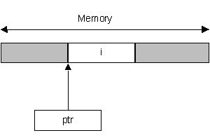

The variable ptr is allowed to point at (or hold the address of) an integer value. I make ptr point at a variable by finding out its address and setting ptr to this:
ptr = &i ;
If this looks frightening, you are not alone. The use of the & character in this way is very strange, in that you have only ever seen this character used for performing the AND operation. However, if the compiler sees & given before a variable name like this it interprets it as meaning "the address of that variable". Since that is exactly what we need to give ptr to make it point at i, all is well. You can get the address of any variable by putting an & character in front of the name in your program. This assignment is shown in the diagram on the right.

ptr equals the location of i.
